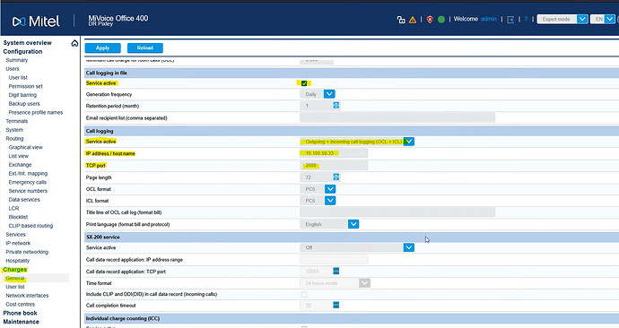

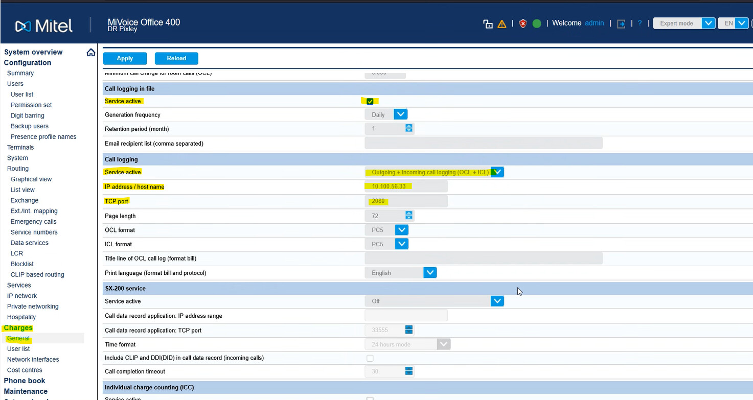

The configuration on the MVO needs to be as follows :
Go to Configuration → Charges → General
On this page change the following:
  • Enable → Service Active under Call Logging in file
  • Choose Outgoing+Incoming call logging → Service active
  • Use the MVO IP in → IP Address
  • Choose Port 2080 → TCP Port
Have the technician apply these changes
Restart the TCPproxy
Tail the tcpproxy.txt to see if the call data is showing
