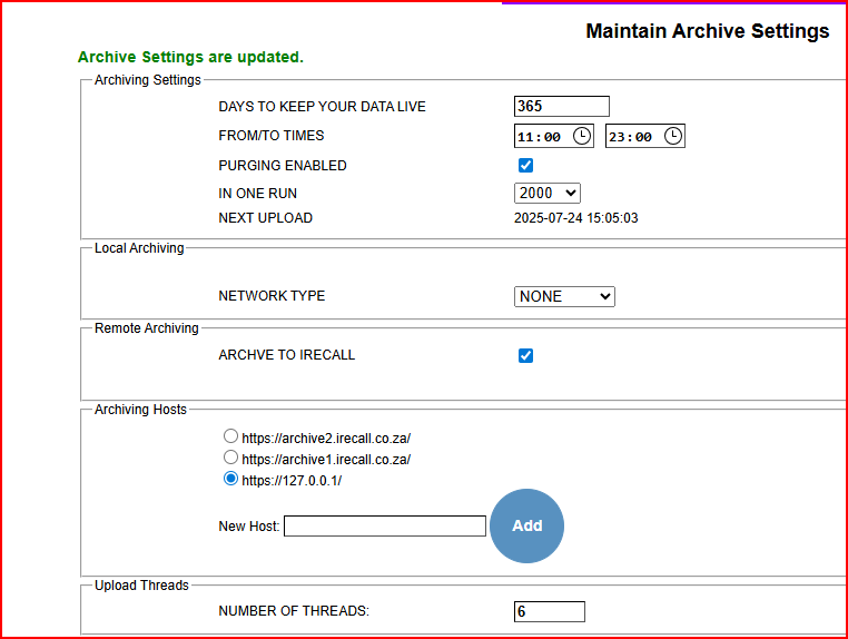

Setup
  • Archiving needs to be enabled on the Archive screen in the webadmin2
  • Add an Archive server as https://127.0.0.1 and select it.
  • The Archive script needs to run to ensure all the calls that needs to be purged as flagged as Ready to delete.
  • The Purge script needs to run to do the actual delete.
